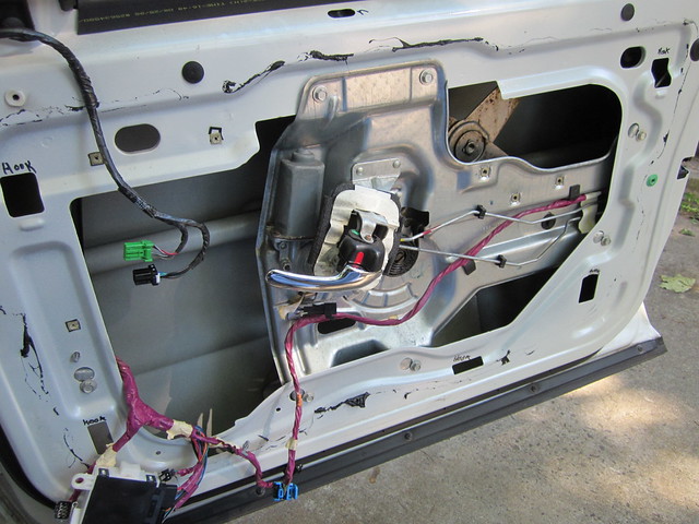

It seems a lot of people complain about the driver's side window having issues on the Park Ave. But the only replaceable component in the mechanism is the motor itself. Everything else is contained in the "door lock module" which is a $$$ item from GM. There's no such thing as a regulator for these cars as far as the aftermarket goes.
I've had my doors apart to this level...
It's easy to se the "module" here, with some X shaped thingie in the back. Can someone tell me exactly which part wears out? My window won't go down sometimes, and it rocks back & forth on the way up.
Help, please.
These cars have a different mechanism than more recent models. I'm not sure what is causing your window to rock back and forth (maybe a loose window track?), but the not going up or down is usually an electrical fault.
