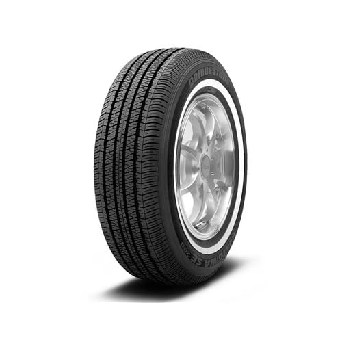

11-19-12.........82,562 miles
4 new tires...Bridgestone Insignia SE200-SP
$485.OO.....Town Fair Tire......... includes alignment and computer balance.
